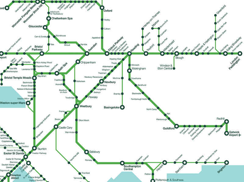

Rail Network (GWR passenger services) putting Melksham into context

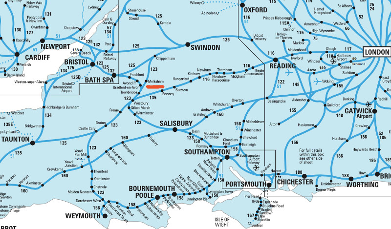

Alternative Rail map (more geographic) putting Melksham into context

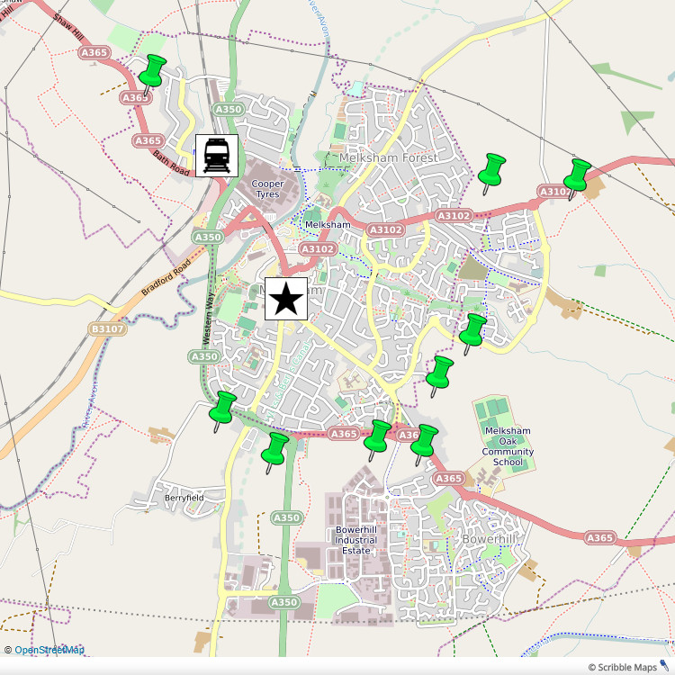

Melksham - Town Centre, Station, and new build housing underway (green pins)

Please can you confirm what the numbers mean on the blue map, e.g. the 123 between Melksham and Chippenham?
National Rail Timetable - Table number 123.   We have a mirror of them all example ...
http://www.passenger.chat/nrtt20/Table%20123.pdf
(just change the 123 to something else ... 125 or 076 or ...
