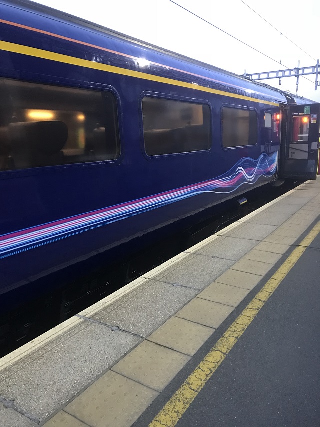

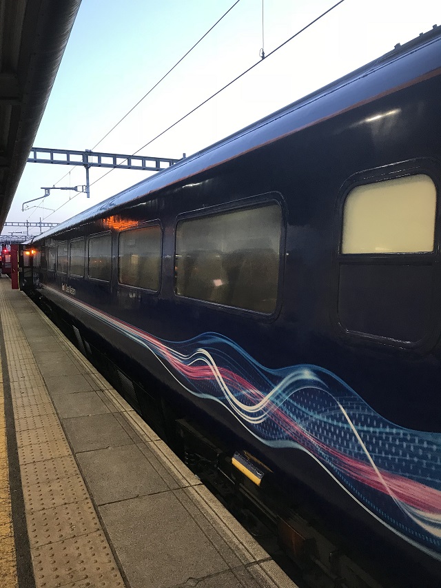

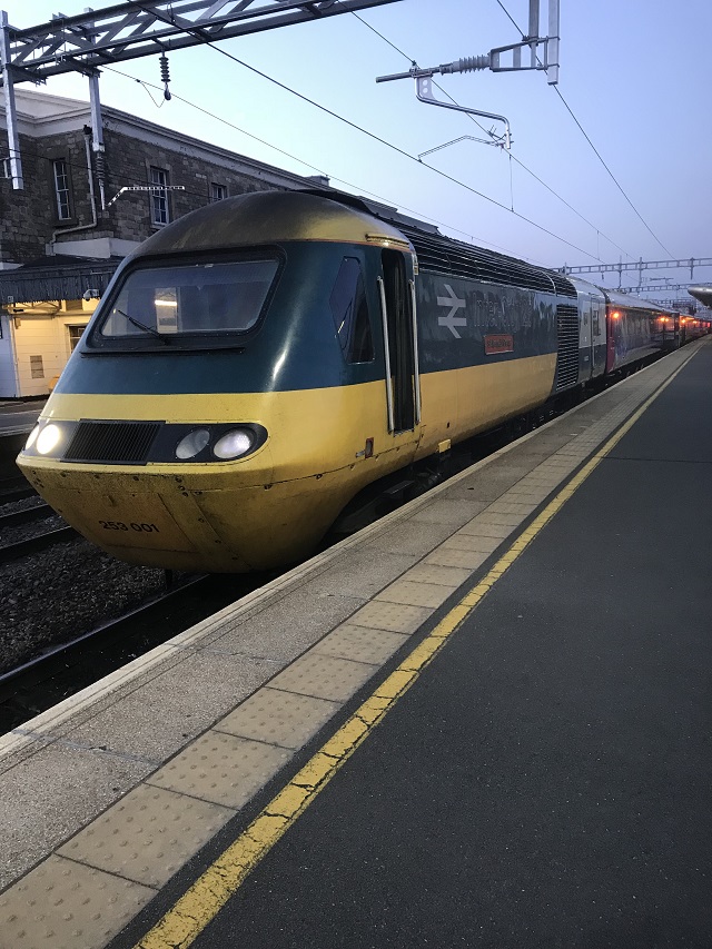

Celebrity power car 43002 Sir Kenneth Grange ran into difficulties on tonight's 19:57 London Paddington to Plymouth service.
The train arrived at Swindon with a liberal coating of diesel down the entire length of the coaches after a leak had developed on the leading power car.   As well as obscuring the view out of the windows there was also a strong smell of fuel on the platform and aboard the train.
The train was already 25 minutes late waiting for crew at Paddington and after another 25 minutes of talking to maintenance the service was cancelled and passengers put on the following service to Exeter which made a special call.
Pictures for the record, but not that easy to see the real extent of the spillage.

Are we certain that it was diesel fuel that leaked ?
The fuel tank is of course underneath and I would therefore expect any escaping fuel to end up on the track, like the toilet waste.
Looks to me as though this might be lubricant rather than fuel? possibly emitted via the exhaust system, or into the engine room and then via the ventilation system.

Not lube oil as that would contain carbon and therefore would be black
It's diesel fuel as bob said from its colourless appearance,and viscosity that has allowed it to spread so far down the trains side .
