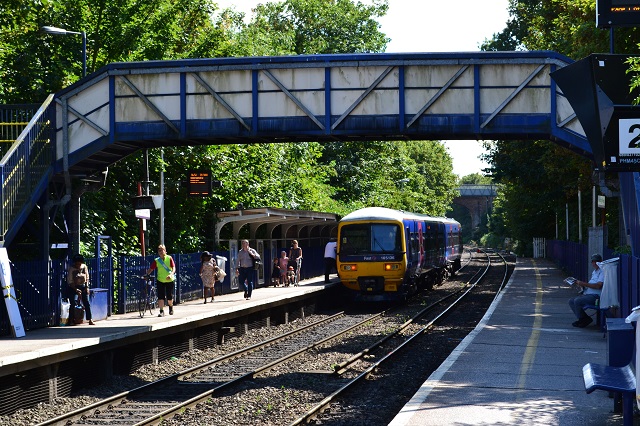

I believe the Footbridge at Reading West was taken down over the weekend
Jason
Posts: 543
« Reply #263 on: July 03, 2018, 06:27:39 »
It was indeed gone yesterday morning.

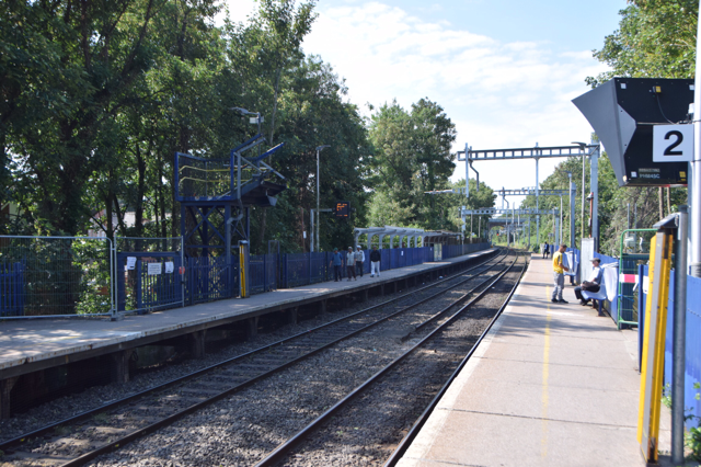

Reading West - July 2014
Reading West - July 2018

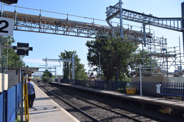

New footbridge under construction
I thought RBC (Reading Borough Council, or Radio Block Centre, depending on context) and Network Rail hadn't agreed on a design/location yet?
Posts: 10240
« Reply #266 on: July 03, 2018, 15:27:54 »
I suspect this is a "temporary" structure which doesn't require permission.  However I understand there is a disgruntled householder who isn't happy that the base at one side is almost in his garden.

« Reply #268 on: July 03, 2018, 17:06:07 »
It could also just be a temporary structure to carry services (that were previously carried on the old footbridge), rather than an actual temporary footbridge.
