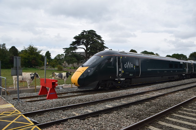

« Reply #16 on: September 12, 2018, 19:51:28 »
Bob, I love your last photograph showing the cows taking an interest in their new train.... Cheesy Roll Eyes
Posts: 10240
« Reply #17 on: September 12, 2018, 19:54:11 »
There is a story there.   Once cow decided she wanted to stand by the kissing gate on the foot crossing which made it difficult for anyone to get past and use the crossing.  Eventually it was decided she was friendly enough and we pushed/squeezed past.
