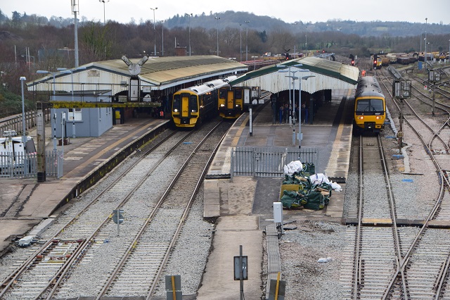

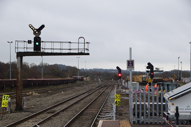

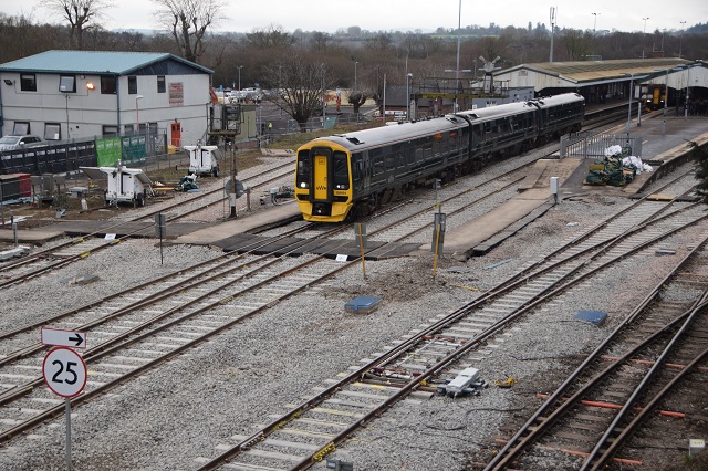

« Reply #101 on: January 08, 2019, 11:19:51 »
A few pictures from the new look Westbury taken yesterday
The signal at the country end of platform 2 is among those which has been moved to allow for longer platforms
Before
Now
Dispatch Box
Posts: 433
« Reply #102 on: January 08, 2019, 13:18:41 »
What a pile of rubbish they have left on the slope of that platform?. Looking at the pictures, Is it right to have a signal right on the platform, thought they would of moved it to the end near to that concrete path, and in that area of ballast. Could be a spad risk where it is. Then there is time to change them during the time that the station is eventually prepared for eventual resignalling.
Posts: 10262
« Reply #103 on: January 08, 2019, 13:24:28 »
Are you talking about the third picture down?   I assume it cannot be moved any further as it would then be too close to the set of points it protects.
