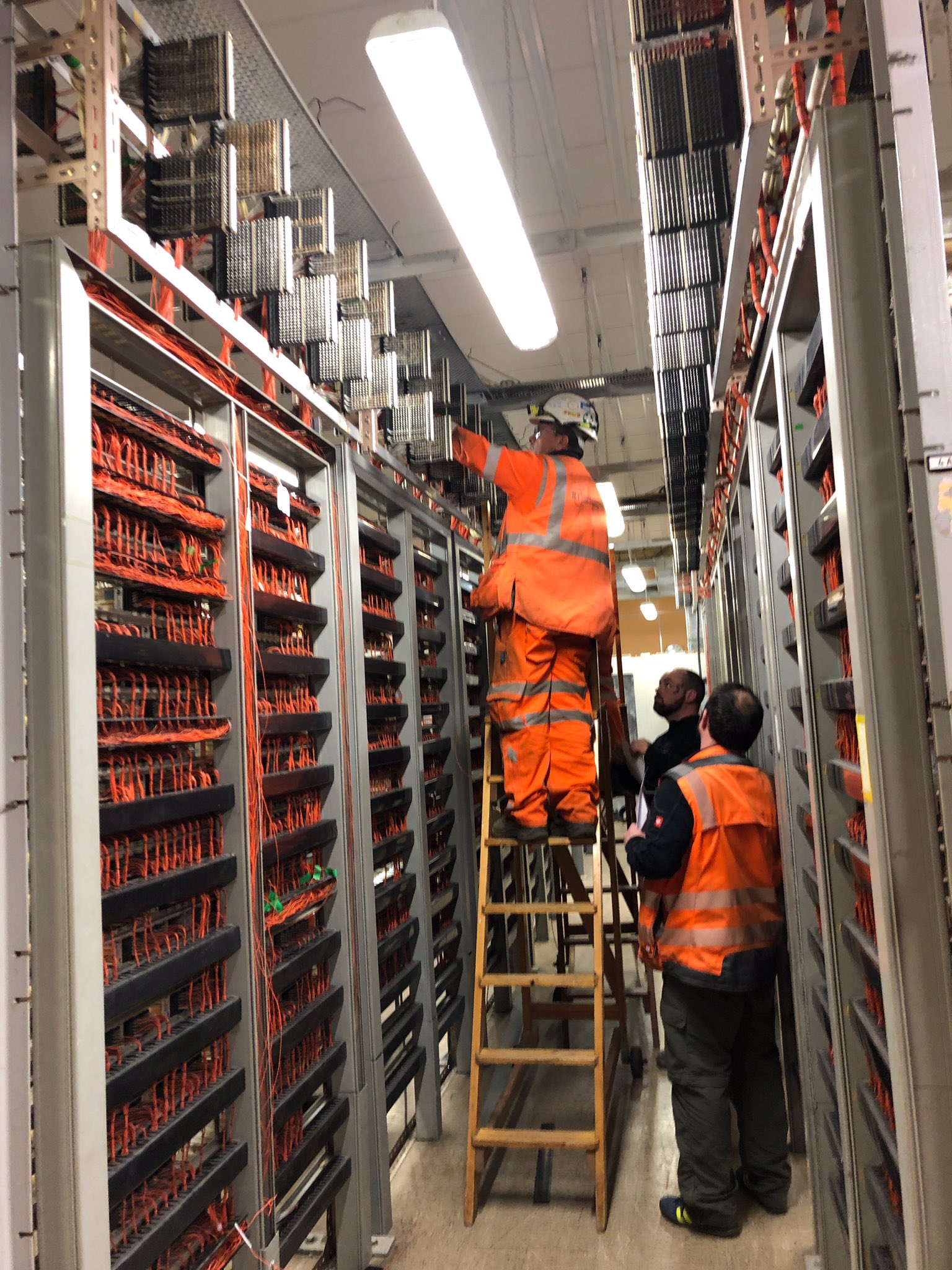

For those who wanted to see NR» (Network Rail - home page) actually working on the problem they have posted this photo on Twitter

A comment on the NR» (Network Rail - home page) photograph posted above.  This shows what is known in BR (British Rail(ways)) WR terms as a 'Post Office Relay Set' rack, well, the wiring side of it at least.  This houses all the interface relays to/from the control/indication panels in Westbury SB (Signal Box).  I note that a few wires that are disconnected are covered with green insulation tape.  Thats a definite NO NO in signalling terms (all the lessons after Clapham appear to being forgotten).  I certainly wouldn't have published that photograph.... Roll Eyes
