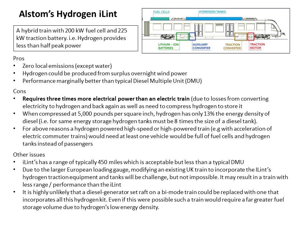

« Reply #19 on: January 15, 2019, 12:19:15 »
A tweet by the editor of Rail Engineer magazine says hydrogen trains require 3 times as much electricity as an electric train and 8 times the fuel storage volume of a diesel, for the same energy store.
https://twitter.com/DavidShirres/status/1083076698231443456
Further to recent Tweets about Alston’s UK (United Kingdom) Hydrogen train, this slide has key points that need to be understood to assess potential of these trains. 2nd last bullet is particularly topical

There's an article about these trains in Rail 870... but I wouldn't rush out to buy it on the strength of that.
The issue of energy density (referred to in Bmblbzzz's post) needs consideration: ICE power plants are typically around 20% efficient (YMMV (Your Method/Mileage May Vary)), whilst fuel cells are around 35%; batteries on the other hand are around 99% efficient - so when comparing energy density, you need to bear in mind how much of that energy is going to make it to the electric motor.
I still don't get why anyone is investing in this technology. Is it something to do with the fact that PPE (Personal Protective Equipment - safety wear) courses don't contain a 'simple applied physics' module?
