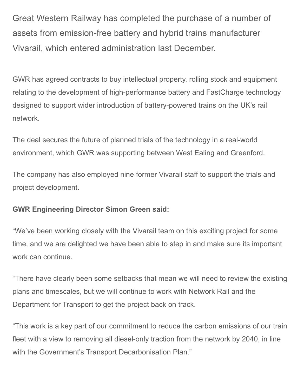

« Reply #58 on: February 17, 2023, 10:46:54 »
Bringing this thread back to life owing to new developments....
From Today's Railways, on twitter
The West Ealing-Greenford fast-charge trial is to go ahead after @GWRHelp agreed to buy “intellectual property, rolling stock & equipment” from the in-administration Vivarail. 230001 thus transfers to GWR (Great Western Railway) ownership. GWR has also employed 9 former Vivarail staff to support the trials
