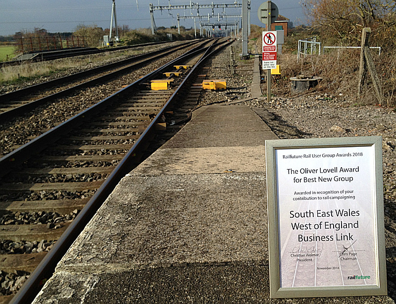

Posted by grahame at 09:15, 21st November 2018
As you travel by train from London or Bristol to South Wales, your train passes through Patchway station ... through tunnels under the Aztec West Business Park where some 7,000 people work, and across open farmland past villages of Easter Compton and Pilning, with industrial and business development just to the south at Westgate being the northern fringe of the Severnside Enterprise Zone.  The train then dips and plunges into the tunnel under the River Severn.
It's unlikely that your train will stop at Patchway - just one per hour does so of the fours that pass through, it certainly won't call at Aztec West as there's no station there, and since late 2016 it can't call at Pilning because the platform was left isolated by the removal of the footbridge, which has not been replaced. So your train has passed through the last 8km of England where there are many journeys starting and terminating - and many more to be added in future years - without any way that the rail network can be used for those journeys.
What should be done in the future?  Is the correct use of the railway for this area for it to convey passengers from one side through to the other without giving them the opportunity to join and leave trains - without giving residents and employees the chance of train travel, without giving businesses and developers the opportunities of progresssing the economy of the (greater) area by improving its connectivity.
There is, still, a station at Pilning. But it's impractical for most people to use.  Passenger trains only call in one direction, and they only call on Saturdays, and then only 2 times.  The station isn't close to where people live int the village not to employment areas, it's on a minor road, and it's not attractive. But it's all that the area has, and quite a number of keen people make a point of visiting it and using it with the intent of keeping it on the agenda, and looking to where it might go and grow in the future.  The current setup appears perverse - an oddity - and the question is raised "how could we improve this for the mutual benefit of all parties" and when we have some answers to that "how do we actually achieve that benefit in real life, and not just in theory"
Earlier this year, I helped in the writing of docudrama or mockumentary piece. The serious incarnation of that - what could be achieved - is at http://www.sewweb.info/leaflet.pdf . Working with people from the area, using my prior experience of helping pilot a service too poor for the area it was supposed to serve and drawing on the skills of an excellent researcher, the piece has turned out to be a pretty good indicative view of the sort of thing than could be done.  And it's very much in line with the early stages of the strategy that I helped with on the TransWilts line -- anatomy of a restructure or reopening:
1. Make people aware there is a case to be looked at
2. Get that case properly looked at and work out what is appropriate
3. (re)gain that now appropriate service
4. Make it work to retain it
Our Documdrama piece was intended to grab attention. To "alight fires of interest" if you will.  Our group ("SEWWEB") garnered some interest early on, but over the last ten days that flame has really been alight.  The group was entered into the RailFuture awards, where it won the Oliver Lovell Award for best new group.  Being recognised by a considerable group of forward looking industry experts, presenation by the retired MD of a major train operator, presided over by a well respected transport specialist author / journalist for sure puts us onto the radar. And it re-ignites the interest and questions from many, many others too who have taken a look at the area in question, the transport in and around, to and from it.  Not all the answers yet, but elephants in the room pretty well identified.  I am marking a date in the new year as a diary entry for this thread - by that point we can look forward at the initial analysis of options with much more clarity.
So - where are "we" now.  A lot of interest. A lot of questions. A number of concerns. A lot of ideas. But as yet No "we are going to do this" or "we plan to do that" - the options need to be looked at and explored, compared, tuned or even turned upside down to come up with the best plans.  And done openly and shared in a friendly way so that as the analysis concludes, a team - and that's a team with so many more people involved and all rowing in the same direction that the group that lit the fire.  Get the analysis done, get the team together, and the way forward is for the mutual benefit of virtually everyone.  Fail to coagulate, fail to come to an understanding and the current oddity will continue providing minimal effective transport, until the next someone says "this should not go on". Let's grab the nettle and help decide for ourselves - for the community and the economy - what's needed and wanted, and not leave it to someone else, by default, at some later date.
I can see four major options around the Pilning area ... I can see three options around Aztec West. Each has varients, long term possibilities though they will be very different. Each will have its own business case which will show some as impractical unless implemented as a political expedient, or as a real motor for the area's future.  For the absence of doubt, the current options at Pilning are for the station to remain "as is", for it to remain in its current location but with train able to call in both directions, for it to move to the B4055 bridge on the outskirts of Pilning Village, and for it to move to where the A403 crosses the railway which is in a very short tunnel at that point.  Each of those options has multiple additional sub-options relating to "how would we do it", "exactly what would we do there" and so on.
Team plan. To gather together the options and overview data for them. To do some initial comparative analysis. To set up a handful of presentations, exhibits, and discussions and visits and to listen and extend or be involved in the setup of a newer and wider partneship with common goals.
At this point, I cannot give definitive answers to all the questions that are flying around.
The person who has had an availability and potential interest for ten years, and who testily demands answers from the SEWWEB team just ten days after we come onto the radar, needs to supply us with data and be patient while we work stages (1) and (2) of the strategy - generating interest, and analysing options, putting them into something of a common form and context, and looking at where we go.
The person who has a tremendous foresight beyond the rest of us, but sees the area purely in maps and figures and possibilities and speculates as a "crayonist", needs to visit - see it in real life, fill gaps in his local knowledge and learn about local emotions and visions.
The person who's a rail enthusiast and lover of the current and history needs to take the brave step, widen and say "what would work for the future; I will listen and suggest"
The person who lives locally needs to listen and inform - to make sure that everyone interested in this firestorm over the last few weeks is informed, and that any outcomes really work for them and for the area - perhaps that the area moves forward rather than risk sinking into something that's unpalatable - or (if I am cyncal) even less palatable than agreed and commonly supported steps forward.
But I can tell you that we will have far more informed and more detailed answers in the New Year and are looking to share them and learn further.
We are talking about physical schemes ... but we are looking at how plans will effect people's lives.
I am - personally - happy to help with a few days of time; I have to look after my own business and direction, but love to be an enabler.  There is a question on the analysis "ooz gonna pay for this" and that question magnifies if the net outcome is a development project.  We are somewhat further ahead on that than you may think; I can already quote guestimates of cost-per-journey of defraying capital costs oer 30 years - and depending on the options and optimisms, they range from under 50p to over £20. It was very interest to hear Ian Baxter of SLC rail affirm talk about project funding and ideas at RailFuture just 10 days ago and, yes, it could be done under the way governance and funding is headed.
One of my great personal joys these days is to take the train from my local station at Melksham.  Where, 10 years ago, I could go to the back of the industrial estate where it's situated and watch rabbits play beside the tracks, these days I meet people who are headed off ... to Swindon, to Bristol, and further afield.  Or they are coming back from watching the football, from a holiday, from work, from a shopping trip, from a day out, from a hospital appointment, from visiting friends and family.  Such a change - such a vision - is also possible for those five miles from the Severn Tunnel mouth through to the northern fringes and first suburbs of Bristol

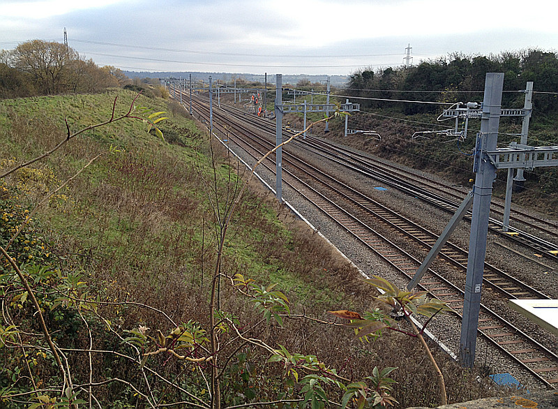

My solution to the Pilning problem is ;-
1. Prepare a trackbed and lay track eastwards from the up loop from the tunnel through the Pilning station site to make the existing usable platform also an island platform connecting to the main line east of the station ;
2. Remove the link from the up loop to the up main to the west of the station and replace it with a link from the up main to the extended up loop with this extended line being re-connected with the up main east of the station ;
3. Install a link from the down loop to the down main west of the station ;
4. Bore a subway east of the station under the up loop. up main and down main and then a bored ramp to the surface and thence continue up the existing platform ramps giving step free access to all 4 platforms of a Pheonix Pilning arising out of the ashes of the current blot on the landscape.
Advantages.
1. no footbridge required ;
2. still retains refuges for goods traffic in both directions ;
3. provides for expresses to pass local passenger traffic calling at the revitalised station ;
4. more attractive for car owners to park and ride with a regular passenger service to both Bristol and beyond and to South Wales ;
Disadvantages.
I don't consider disadvantages when I make plans/suggestions, I only look on the positive sides of things because otherwise you'll never get anything done, full stop.
Notes.
1. If they can bore a full size railway tunnel under a crowded Central London then modern tunnel boring technology should be able to bore a pedestrian subway under a main railway line in a sparsely populated area of South Gloucestershire.
2. I am dreaming.
