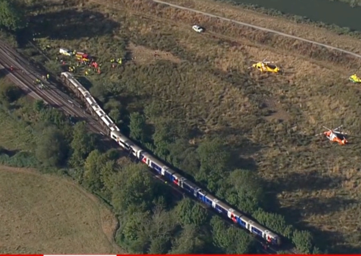

The Rail Accident Investigation Branch has released an update into its ongoing investigation into the train derailment at Lewes in East Sussex.
At around 15:54 on the 13th August 2026, 1F34, the 14:24 Southern service from London Victoria to Eastbourne, derailed around 1 mile north of Lewes station.
The service was formed of eight carriages, and the rear three vehicles derailed and overturned, coming to rest on their side on an embankment.
150 people were on the train when the derailment happened. 30 people were injured in the accident; 20 of those required hospital treatment, some with serious injuries.
The first RAIB inspectors arrived on site at 19:11 to secure evidence alongside the British Transport Police.
The RAIB has downloaded the On-Train Data Recorder and is currently analysing this alongside CCTV recordings and signalling data.
This accident took place on the Down Lewes line, where the maximum speed for a train is 70mph. The two Class 387 units on 1F34 were coupled together and were travelling at around 65mph as it approached the point of derailment.
Initial analysis shows that the driver applied the brakes at the point of derailment, and the train began to slow down.
Marks on the rail near the point of derailment are consistent with the wheels of the derailed carriages climbing over the rails.
CCTV images from 1F34 and other services show that track geometry irregularity existed on the approach to the derailment.
The RAIB says that there is also evidence of previous track maintenance activity in the area.
Several reports of rough riding in the area were also received by the RAIB following the accident.
The embankment that the railway runs on is constructed of clay and alluvial/alluvium deposits, both of which the RAIB says are sensitive to variations in the water content.
However, the RAIB says that there is no evidence to indicate that an embankment slip occurred before the accident – although it does say that there is evidence of some previous movement.
The investigation is continuing to look at
the exact mechanism by which train 1F34 derailed
the status of the track at this location and how it was inspected and maintained
the condition of the embankment, including the presence of any coincident risk factors (such as sustained hot weather, nearby structures, and vegetation), and how it was inspected and maintained
the weather conditions in the area on the day of the accident, and in the weeks and months preceding it
the effectiveness of any mitigation measures intended to address the risks of operating trains in hot weather
the condition of train 1F34 and the crashworthiness performance of the rear three vehicles of the train during the derailment
the emergency response to the accident
any relevant underlying factors, including any actions taken in response to previous relevant safety recommendations.
The RAIB have released the site back to Network Rail to allow for repairs to take place and the train to be recovery.

| Re: Lewes, East Sussex - derailment of train, 20 injured, 13 August 2026 Posted by JayMac at 18:21, 13th August 2026 | ![]() ![]() ![]() |
It is the three rear vehicles that have toppled. Unclear at this point if any of the front 5 also derailed.
| Re: Lewes, East Sussex - derailment of train, 20 injured, 13 August 2026 Posted by grahame at 17:50, 13th August 2026 | ![]() ![]() ![]() |
Victoria to / via Eastbourne service. Still from the BBC live / helicopter feed.
Edit to add - reported as 1F34, 14:24 from Victoria comprising units 387172 (GBR Livery) and 387304, site not far north of Lewes. More facts to follow (and others welcome to pass them on / quote them). Please do not speculate. Reports suggest as a minimum some injuries - thoughts with those hurt, their friends and family, and staff and others involved.
