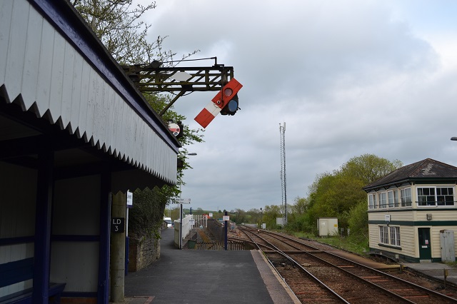

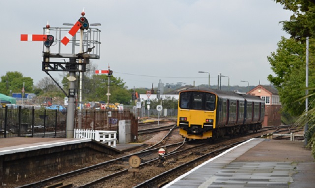

Well it will signal (Roll Eyes) the end of some significant and historic signalbox structures (some of which I know are to be preserved):
Plymouth Panel opened 1960
Liskeard opened 1915
Lostwithiel opened 1893
Par opened 1882 (estimated but believed to have signalled Broad Gauge trains)
St.Blazey opened 1908
Goonbarrow Junction opened 1909
Truro (Former Truro East) opened 1899
Roskear Junction opened 1895
St.Erth opened 1899
Penzance opened 1938
So even the youngest is 54 years old.  Can't see ERTMS (European Rail Traffic Management System. A future railway signalling system, with equipment located in the driver's cab, rather than lineside) lasting that long Tongue
