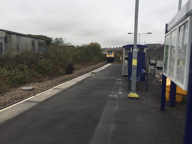

a) Can they be programmed to display "the next train does not stop here - please stand back"
b) Can they make announcements (over a limited area, of course)
c) I've noticed "communication error" messages up a bit too often for my liking - though my main experience is of the Melksham machine.  Also seen it at Saltash.  Do others display this error message rather than train times very often?
They're just web browsers with a mobile connection - they can in theory display anything you like. There's a central site for them with several pre-baked layouts, but showing something different should (in theory!) just require altering the code running on the server, rather than anything actually on the unit itself.
I've taken a look through all the standard formats ... and none of them includes trains passing without stopping, I'm afraid.  That data's not in the XML source either.   They CAN display an extra messages added by 'control' (?) such as telling people that buses and taxis are on the way;  that's not used as quickly and routinely as I would like, but it is there.  For every case of "next train DOES NOT STOP" that would potentially be a lot of effort and I suspect the best solution would be a yellow line ...  [[ should have noted - original question based on a case of someone straying rather near the platform edge ... getting a bit of a fright as an HST (High Speed Train (Inter City class 43 125 units)) came though - "I thought all trains stopped here" ]]

The systems at larger stations have a "please stand back as the next train does not stop" message so there must be a code in that system. Is it a different system?
I believe that the HTML (Hypertext Markup Language) page sent to the screens, as currently specified, can be told to show a general warning in large text in the blue section at the top. Here's a local example right now: http://iris2.rail.co.uk/tiger/rendercis.asp?file=3053C6.xml (this may change by the time anyone clicks on the link, of course!). So GWR (Great Western Railway) could configure this to say "Fast trains are passing through Melksham today without stopping - please stand back from the platform edge."
But really, what I was getting at was more that the answer to "can they be programmed" is surely yes, they can, if GWR pay ATOS Worldline some money to do so. Wink

Going back to the issue that caused the question, I would have thought the driver of a fast through train should sound his horn if there are passengers close to the platform edge, or are heading in that direction. More so if the driver knows that the route is somewhat unusual, so passengers are less likely to be expecting the fast service.

He/she did!
It is a bit of an optical illusion but an HST (High Speed Train (Inter City class 43 125 units)) approaching from the south does not appear to be going that fast when it gets close to the platform at Melksham.  In reality it is probably doing 40 to 60mph.

Yellow line: I thought every platform which fast trains pass without stopping, even occasionally, had one. I would have taken the absence of a yellow line to mean that all trains stop or pass slowly.

Melksham hasn't yet....
