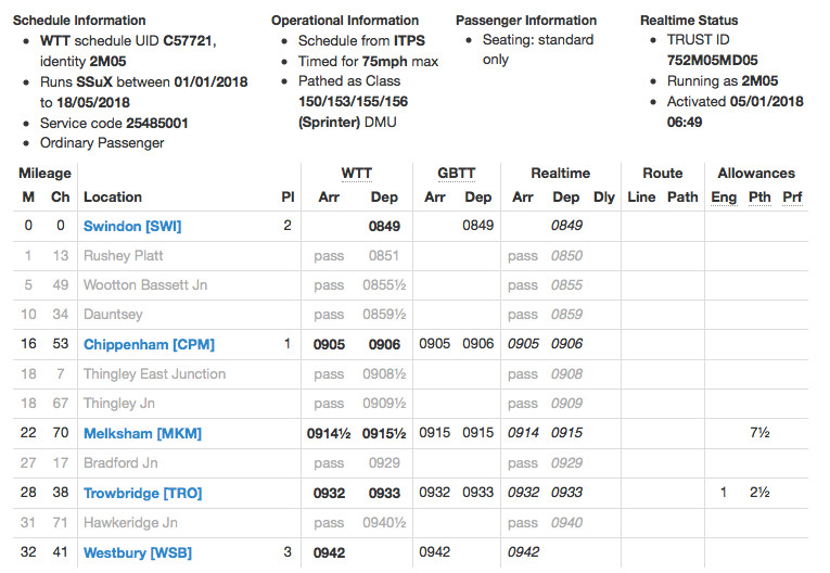

Here's the Real Time Trains schedule for this morning's 08:49 Swindon to Westbury
What do the allowance mean, and what should I read into them?
Eng?
Pth?
Prf?
I had previously understood that "Pth" was "Pathing" - in other words a train slowed down to keep it out of the way of something else later in it's journey.    And from that I concluded that a service showing significant "Pth" through Melksham but not stopping there would be operationally easy enough to call if we made a business case - especially if there was a precedent for that type of train calling at Melksham.   However, I'm told I'm wrong ... 13 minutes of Pth isn't enough to add a call.   Can someone explain, or might you suspect (like I do) that I'm being fed a porkie?

The pathing in this case seems to allow a SWR» (South Western Railway - about) Bristol -Salisbury train to pass Trowbridge before the Melksham service gets to the mainline. I does not appear on some of the other services.
I agree with you and that 08:49 is a slower service.
But all is not what it seems. There are other services at times of engineering changes that also have what appears to be padding marked "pth" in them - up to 13 minutes in some cases and services that skip Melksham. However, I'm told that there isn't enough time within those specific schedules to make the stop. So it looks like I don't fully understand "pth" (or it's a convenient excuse to give ...).

Issues tomorrow too - with Bath to Bristol closed, Portsmouth - Cardiff has become Portsmouth - Swindon.  Alternate trains in each direction have Melksham calls - EXCEPT that there's nothing northbound from 08:29 to 12:06.  No bus either.   Rather oddly, the 09:59 from Trowbridge passes through at about 10:08 and has 2.5 minutes of pathing allowance and takes 20 minutes between Trowbridge and Chippenham rather that the usual 18 or 19 for similar units with a stop at Melksham.   Scratching my head and asking "why not stop what would be the busiest train of the day", and not coming up with any logical answer.

Rather than go absurd early (08:29) or miss my own meeting (12:06), I caught that 09:43 the other way and changed at Trowbridge.
On time off Trowbridge
Slowed through Melksham at 10:07
Halted before Thingley Junction for that 2.5 minutes Pth (Bath - Swindon HSTs (High Speed Train (Inter City class 43 125 units)) crossed ahead)
S-l-o-w run into Chippenham because we were behind the HST
On time into Chippenham
Still don't understand why there was a signal stop at the top of the single line rather than a Melksham stop in the schedule.
