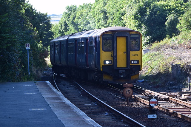

Posts: 10262
« Reply #5 on: December 07, 2020, 12:21:26 »
This ground position signal failed locking the points.  (Picture from July 2018)
IndustryInsider
Posts: 10479
« Reply #6 on: December 07, 2020, 13:17:11 »
Where's S&T (Signalling and Telegraph) when you need him?  Grin
In true S&T style, I'll just politely point out that it is a semaphore shunting signal, and not a ground position signal.   Wink
TonyN
Posts: 521
« Reply #7 on: December 07, 2020, 16:24:36 »
I guess someone overtightened the wire during the summer. So on a cold morning the signal will not go back properley and holds the points over because the detection slide has not fully returned.
