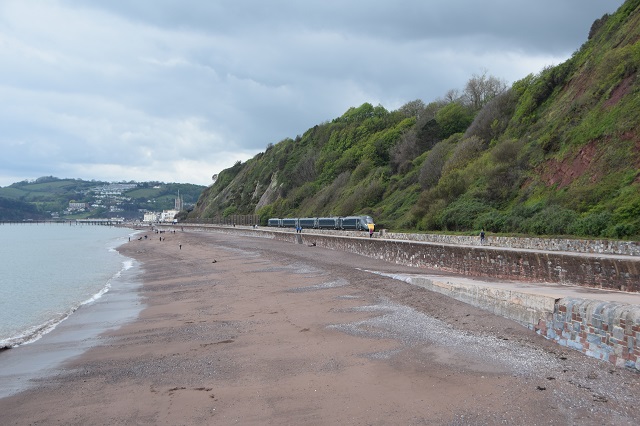

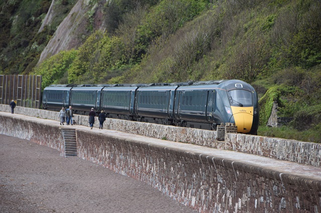

« Reply #310 on: May 14, 2021, 17:10:53 »
Well if there were 17 IETs (Intercity Express Train - replacement for HSTs (manufactured by Hitachi in Kobe, Japan)) out today, I saw two of them.
