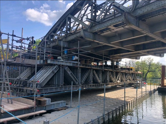

I’ve seen in other forums that the bridge span was jacked level by yesterday. There’s a Twitter picture here that’s a good view of the present situation:
https://twitter.com/507stre/status/1655619283479560196
ellendune
Posts: 4525
« Reply #192 on: May 09, 2023, 12:00:51 »
 Here's the picture from Twitter:
Well I tried.  Why can I only get that to work 50% of the time?
I was going to add that that is just as I imagined it would be done.
Now the real work can start on the new abutment.
« Last Edit: May 09, 2023, 12:11:34 by ellendune » Logged

600mm. Blimey. Impressive.
Posts: 44248
« Reply #194 on: May 09, 2023, 13:45:47 »
