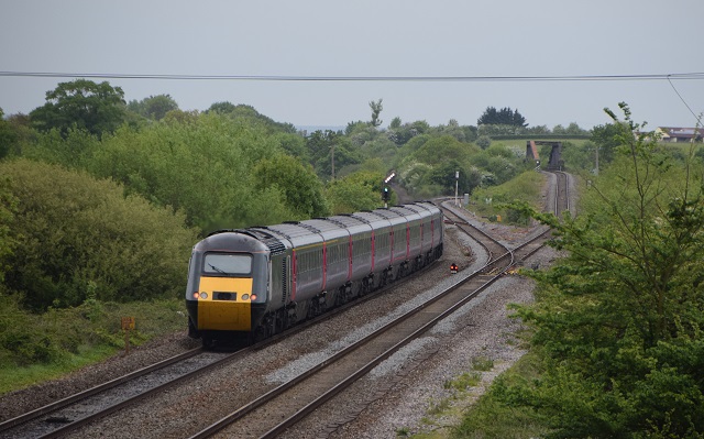

Journeycheck put the 21 minute delay down to a problem with the signalling system.
Approaching the junction at 90mph clearly isn't going to give you enough time to see if you have the feather or not and react in time if it is wrong.
This picture from May 2018 shows a GWR (Great Western Railway) HST (High Speed Train (Inter City class 43 125 units)) being shown the route via Athelney.
