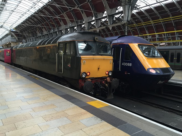

Pleased to say, for once, I wasn't a jinx on the sleeper and this morning's 1A40 arrived spot on time at Paddington at 05:12.

I've used the sleeper for my commute in Cornwall 10 days of the last month. I've only encountered 57604 and 57303. All journeys have been within 1 minute of schedule.
