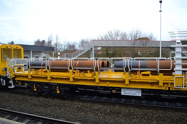

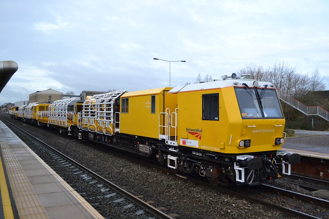

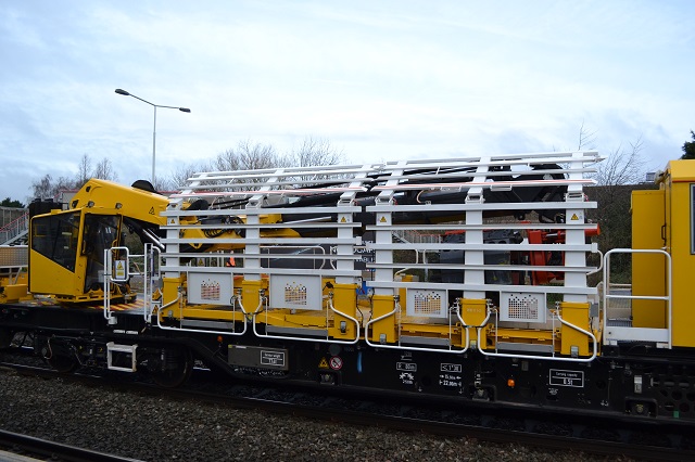

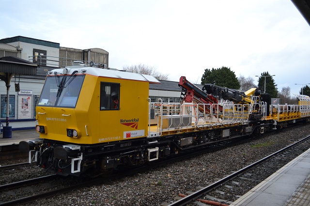

« Reply #877 on: March 07, 2014, 18:54:02 »
Saw this at Swindon today - looks to be part of the High Output Plant system (HOPS) train - all shiny and new.
Couldn't see too much of the rest of the train as the "safety guards" were on my side of it.

« Reply #878 on: March 07, 2014, 19:15:42 »
That looks like the 'Excavation and Concrete Batching' section of the HOPS train:
http://www.railexpress.co.uk/news/new-factory-train-will-slash-gwml-electrification-schedule

Posts: 10240
« Reply #881 on: March 07, 2014, 20:16:36 »
Thanks - yes that looks to be the one.  I was told it was going for a run from the depot, into Swindon to change ends, then off to go around the Didcot triangle to turn it.
