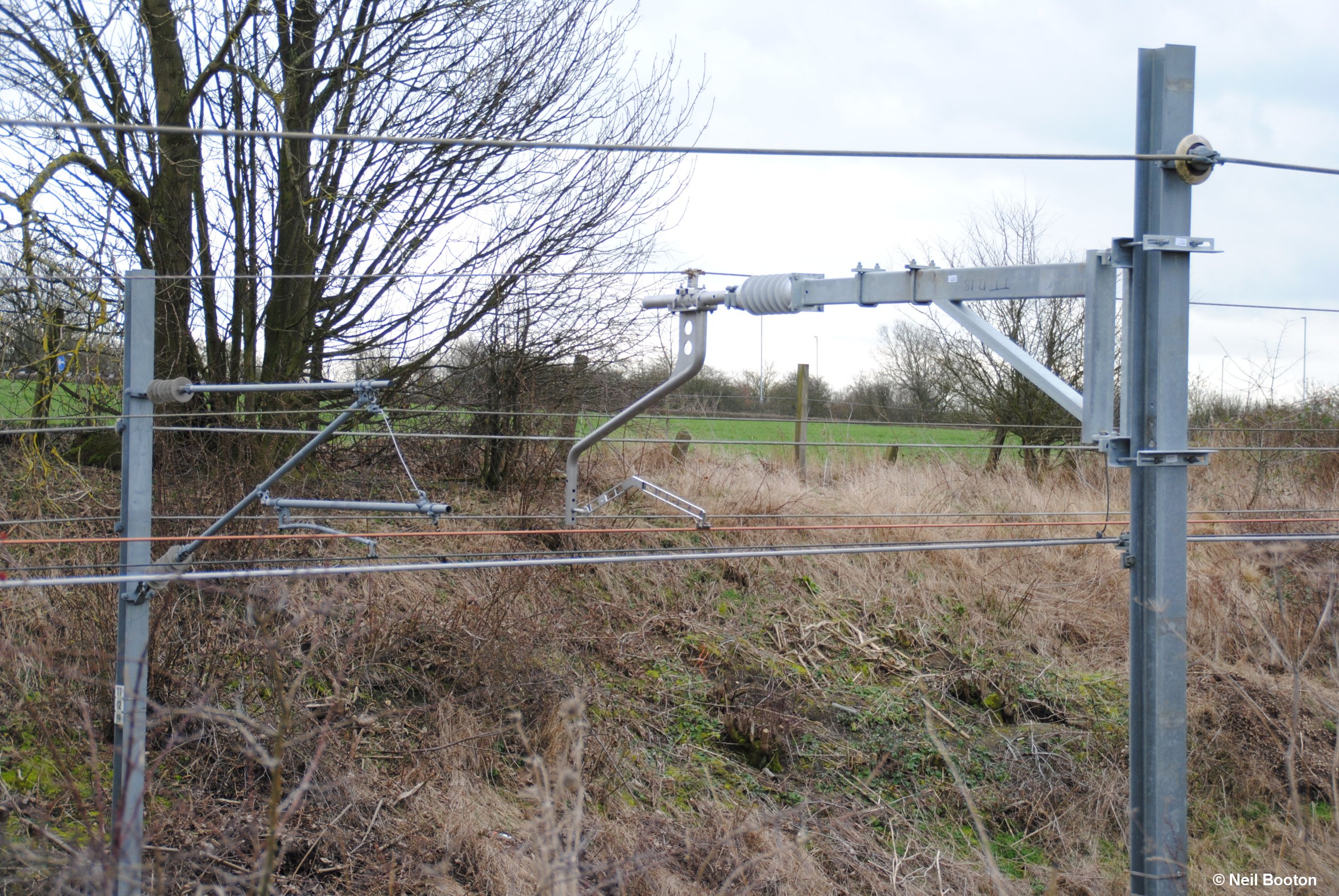

I found a few photos on the site dedicated to the Old Dalby test track that conveniently show old and new side by side.  The shot below suggests that the UK1 masts are generally stronger and higher, and although it's only a single track cantilever shown, all the hardware seems to be mounted level with or higher than the contact wire, the old type on the left the cantilever is mounted lower, IYSWIM:
http://www.old-dalby.com/images/14-02-03_new%20registration%20arm.jpg
What might also be significant is that the GWML (Great Western Main Line) is a '25 kV - 0 - 25 kV' autotransformer installation.  The additional catenary(s) that form the second, anti phase 25 kV supply (the autotransformer feeder - ATF) are normally mounted outside and higher than the portals or cantilevers, if starting with a brand new installation they may have decided to place the ATF higher, because they can.   There are also earth conductors strung along the masts, IIRC ('if I recall/remember/read correctly') - perhaps the more space between everything the better.
