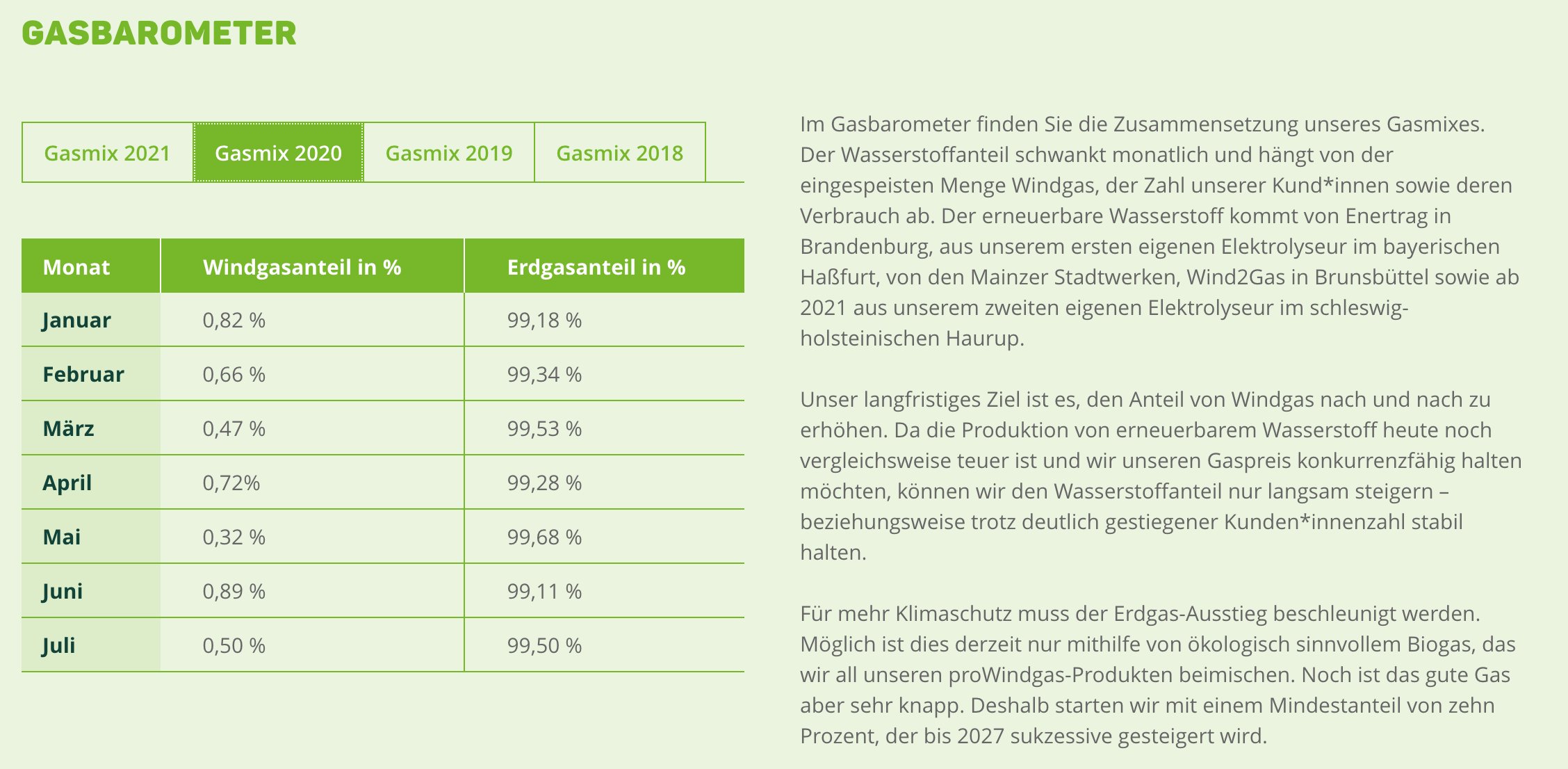

Another way, of course, would be to convert the engines to run on gas instead. The fuel could then be bought from Greenpeace Energy in Germany, who produce sustainable non-polluting gas by adding hydrogen to it, said hydrogen being produced by electrolysis using wind power. The proportion of hydrogen to methane varies a bit, depending on how windy it is, but as this table shows...
... it occasionally approaches 0.9%. Yes folks, Greenpeace uses its name to sell fossil fuels in Germany.
« Last Edit: January 28, 2021, 23:02:59 by TonyK » Logged
